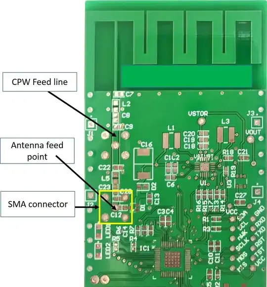

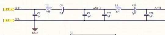

  1. First, by shortening L2,C8,L5,C23, I measured my antenna "raw" impedance (without matching) at ANT1 terminal (please see attached my matching network). It gave Za_raw = 133 +j 226 (ohm). RF+ is the input feed line of my antenna. There is a SMA connector at ANT1. It connects the rest of my circuit to the antenna. matching network

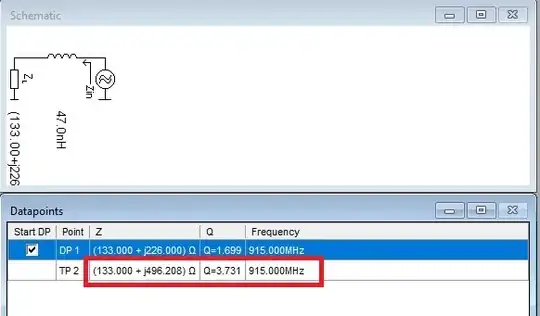

  2. Then, if I replace C23 with an inductor L = 47nH, the measured impedance at ANT1 terminal is 60 + j160 (ohm)!!! But using Smith chart, with Zload = Za_raw, a serial added L of 47nH would give Za = 133 + j 496 (ohm). You can see this in the following figure. enter image description here

Here is my construction. I shorten L2, C8, L5 & C23 using wires. The physical length of the feed line is about 29.5mm.
  • The reason for the complicated matching network is that, at first, I would like to make 2 measurement points: at ANT11 and ATN1. ANT1 should be the input impedance of my circuit, while ANT11 should be the antenna input impedance. But later, I thought I don't need to do that. I just need to tune the input impedance of the whole circuit (with all components soldered) at ANT1 to be 50 ohm!
  • Why 50ohm? In my measurement, at the resonant frequency (around 915 MHz), the impedance at ANT1 is 50ohm!
Am I right? enter image description here

Firstly, at 900+ MHz, shorting out components to take antenna impedance measurements is not a good practice as the lead length can be a substantial portion of a wavelength. Stray inductance and capacitance must also be avoided.
Secondly, your matching network appears horribly complicated for an impedance matching circuit. Generally, a simple "L" network (one inductor and one capacitor) will accomplish the match. If you are attempting to do something else with the network, such as bandpass shaping, please edit your question to explain this. You should also state the desired final impedance of your antenna system.
Thirdly, without seeing your physical construction, it is likely that the wires or traces of your shorted out matching network are acting as a transmission line. Any transmission line length that is not a multiple of 1/2 wavelength will transform the antenna impedance. At 915 MHz, even a 30 mm length of transmission line has relevant transformative properties. In order to properly model this, you would need to know the electrical wavelength and the characteristic impedance of this unintended transmission line. This is yet another reason to take the impedance measurement directly at the antenna feed point.
