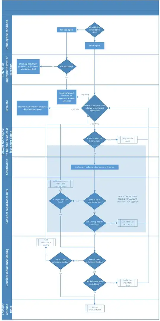

For dipoles already tuned to the proper frequency, I would answer "they do not need it". For other cases... it gets difficult to describe so please see the flow chart below.
dipole decision tree
Summary: Best case would be a full size, half-wavelength, tuned dipole. But if there is a wire length restriction for whatever reason, adding a set of "cap hats" is truly a no-brainer.

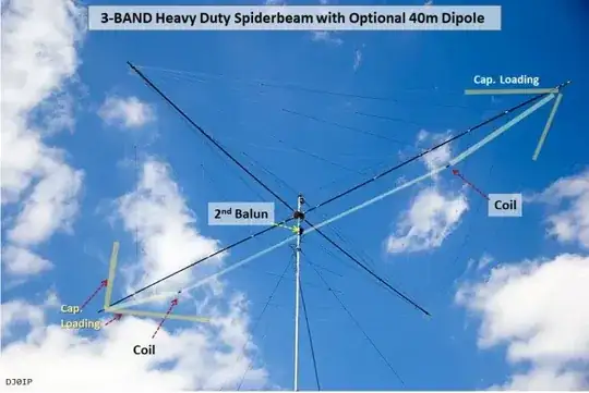

Here is a photo from DJ0IP showing his 40 meter cap hat dipole below his spider beam:
