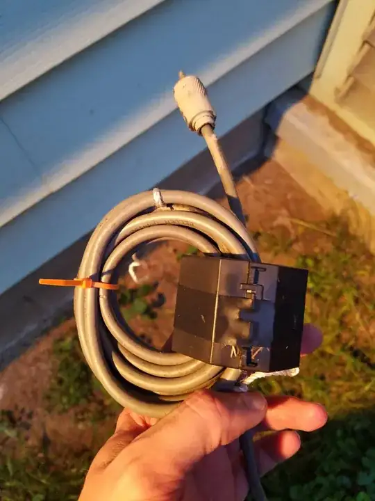

EDIT: My choke consists of 8 turns of coax through a mix 31 big clamp on bead.

    I added my choke to the original post. Will that suffice? – Paul Aug 25 '18 at 00:35
  • @Paul Very good! I edited your post and changed your link to show the actual photo there. – Mike Waters Aug 25 '18 at 00:55
  • @Paul Ok, you're using RG8-X and RG-6. Which is the light-colored coax? And which type is the dark colored coax? Most importantly, where is the antenna connected in this photo? Please go back and read Phil's answer here. :-) – Mike Waters Aug 25 '18 at 01:00
  • That came from my old antenna. It is just an example of how I plan on making the choke. It sounds like I should do it with the RG-6 at the feedpoint of the delta loop. – Paul Aug 25 '18 at 02:00
  • @Paul Understood! You are correct. – Mike Waters Aug 25 '18 at 02:01
