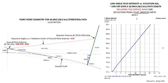

Good things to recognize in understanding the performance of this system are that:
  1. The software often used to evaluate these situations usually is set by the operator to consider only the "far field" radiation, and ignore the surface wave
  2. The far-field calculations of MoM software such as NEC assume a flat reflecting plane for systems not evaluated for their performance in free space, and show the field or gain existing for an infinite distance from the radiator
  3. The propagation environment of item 2 above does not apply to relatively short, terrestrial, point-point paths over real, curved Earth
  4. If the surface wave is not included, NEC and similar software is not appropriate to evaluate the performance of short, point-point terrestrial paths — such as used by a VHF/UHF HT to reach a repeater.
Below is a NEC4.2 study of a 6m transmit system linking to a distant repeater, including its radiation at the lower elevation angles producing the surface wave.
It can be seen that the radiation from an elevation angle of only 0.8° is responsible for the field intensity arriving at the repeater antenna (Earth curvature has a ~negligible effect on this analysis, for this path length).
A NEC far-field (only) analysis for this setup would show almost no radiation from this transmit antenna at an elevation angle of 0.8°.
Added later: It would be useful to me and perhaps others if the person downvoting this answer would add a comment to it offering the reason for doing so. Nothing given in the answer is factually inapplicable as a response leading to an accurate analysis of the question asked in the OP.
