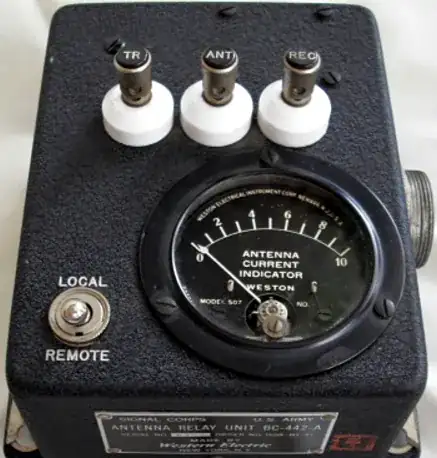

That's how I tuned my homebrew transmitters for max back in the late '60s and '70s. My RF ammeter was a WWII military surplus unit (pictured below), and measured from 0-10 amps. The meter was fed from a thermocouple unit inside the case.
WWII surplus BC-442-A RF ammeter

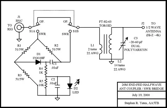

I can't say it was used historically, both because 50 ohm loads were not the norm they are today, and LEDs did not exist, or even solid state diodes if you go back far enough, but one way to tune an antenna without an SWR meter is given by example in AA5TB's tuner:
R1, R2, and R3 form a Wheatstone bridge, with the antenna making the fourth leg of the bridge. The LED is dimmest when the antenna impedance is near 50 ohms. I've explained the operation of the circuit in more detail in another answer.
This is interesting in that there's no directional coupler, so it doesn't measure forward and reverse power like a typical SWR bridge. Instead it just measures how close you are to 50 ohms (or any other impedance, if you swap out the resistors) which accomplishes the same objective.

    I think he means the LED is dimmest when the antenna is nearest 50 ohms, because then the brdige would be balanced, D1 would not have a signal to rectify and so would not drive the LED. – Paul Jul 01 '19 at 20:08
    right you are, thanks for the correction – Phil Frost - W8II Jul 01 '19 at 23:26
