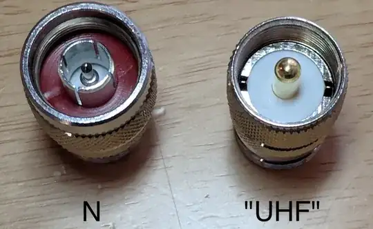

Broadly, all you need to do is follow the coaxial cable down to wherever it ends, and hook it up.
However, you will most likely need an adapter, because the connector on the end of the cable will not be a TV-coax "F" connector. Most likely, it will be a "UHF"/"PL-259" connector, or an "N" connector. You can find an adapter from either of those, or any other common RF connector, to a "F" type connector which is the kind used for TV antennas and cable TV; it will cost a few dollars.
(The reason I say that it won't be an "F" connector is because amateurs most often don't use "F" connectors, and because the coax is too thick for a standard "F" connector — besides eyeballing the size, I also faintly see it is marked "RG 8/U" on the part running across the top of the photo.)
N and UHF connectors
