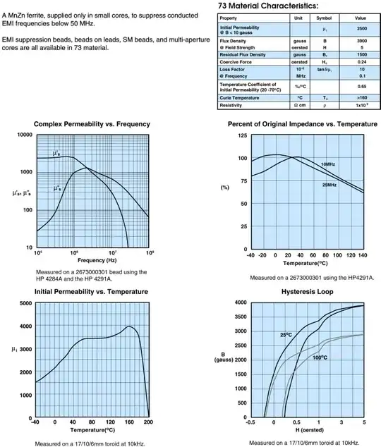

Datasheets for ferrite materials are usually filled with incomprehensible graphs with greek letters. For example, Fair-Rite's 73 material:
Fair-Rite 73 material datasheet
What's a $\mu'_s$ and a $\mu''_s$? What do these numbers represent, and how can I use them in amateur radio? Do they allow me to predict inductance or losses of inductors made on cores of this material? What is the relevant math? Why are these parameters dependent on frequency, and what are the relevant consequences for amateur radio?

The first, and simplest measure of permeability is in the table, under initial permeability. This table doesn't specify units, but it could be gauss/oersted or G/Oe, which are CGS units. The nice thing about G/Oe is that the permeability of air or vacuum (conventional symbol: $\mu_0$) is 1G/Oe, so permeability in G/Oe is also relative permeability, which is usually what inductance calculators expect. This is not true when using SI units, where $\mu_0 = 4\pi\cdot10^{−7}\:\mathrm{H/m}$.
However, the permeability of ferrite is not linear. Due to its physical properties, the permeability effectively drops with frequency. The picture is further complicated at high frequencies because it takes some time for the core to magnetize, so at high frequencies, the magnetic flux density (B) might lag significantly behind the magnetizing field (H). From the perspective of the electrical circuit, this looks like higher losses in the form of a series resistance, and reduced inductance.
We can break this "lag" into in-phase and out-of-phase components, and it becomes a complex number. The first graph, Complex Permeability shows this. , $\mu'_s$ is the in-phase part of permeability, the part that makes inductance. $\mu''_s$ is the out-of-phase part of permeability, the part that makes losses. This is very similar to how we might represent impedance, with one part being reactance (capacitance or inductance) and the other part being resistance.
The ratio $\mu''/\mu'$ is also the ratio of energy lost vs. energy stored in the inductor. This quantity is called the loss tangent, and is also written as $\tan \delta$. It is also the reciprocal of the quality factor $Q$. If you've calculated or measured the inductance $L$, you can also calculate the equivalent series resistance:
$$ \tan \delta = \frac{\mu''}{\mu'} = \frac{1}{Q} = \frac{R_\text{ESR}}{2\pi f L} $$
A related parameter, loss factor, is expressed in the table. This is simply the loss tangent, divided by the initial permeability. It is done this way because including an air gap in the core reduces the loss tangent at the expense of decreasing the permeability. Note that the loss factor in the table is specified for a low frequency; at high frequencies $\tan \delta$ increases significantly and you will have to calculate the loss factor for yourself from the graph.
The last concern we have is core saturation. This one is pretty easy if we can assume all the magnetic flux is inside the ferrite. For inductors wound on closed shapes like toroids or E-I cores, this is reasonable. There's an entry in the table: Flux Density @ Field Strength. This is where this material saturates. It can also be determined graphically from the Hysteresis Loop: the point where the two black lines meet at the upper-right is saturation.
All we have to do is translate between current in the coil around the core and field strength. This is pretty easy if we convert oerstead to the equivalent SI unit: ampere/meter:
$$ 1 \mathrm{Oe} = {1000 \:\mathrm A \over 4 \pi \:\mathrm m} \approx 79.58 \: \mathrm A / \mathrm m $$
Here, ampere might more intuitively be called an ampere-turn. They are the same thing dimensionally. The "per meter" part refers to the nominal length of the magnetic circuit: for example, the circumference of a toroidal core. So for example, say we have a toroidal core with a circumference of 4cm, with 10 turns on it, with 500mA. The field strength is then:
$$ \begin{align} \frac{10 \cdot 0.5 \:\mathrm A}{0.04 \:\mathrm m} &= 125\:A/\mathrm m \\ 125\: \mathrm A/ \mathrm m \cdot \frac{4 \pi}{1000} &\approx 1.57\: \mathrm{Oe} \end{align} $$
This is less than the 5 Oe in the datasheet, so the core is not saturated.

Permeability is the measure of the ability of a material to support the formation of a magnetic field within itself or more simply, the inductance per unit length. Magnetic permeability is typically represented by the Greek letter μ (mu) and is measured in henries per meter.
It's helpful to remember that inductance here is a complex number.
In the context of these ferrite material data sheets, $\mu'_s$ represents the ‘effective’ relative magnetic permeability (the real part of the permeability). This depends upon the choice of material and the size and shape of the rod or core. This permeability also varies with the frequency.
Why does this vary with frequency? Because ferromagnetic material becomes more and more magnetized as the current increases. Initially, the magnetic domains within the ferrite are randomly oriented and the ferrite exhibits no particular magnetic properties. As the magnetic flux increases, more and more of these magnetic domains become aligned with the magnetic field. At a certain point the material becomes saturated and all the domains aligned, no further increase in permeability can occur.
How is this useful in radio? For an antenna constructed around a ferrite rod, like the AM broadcast antennas discussed previously, the radiation resistance of the antenna is raised by a factor of μ2 by winding the antenna around a ferrite rod. This is extremely useful as the radiation resistance of such an electrically short antenna is on the order of tenths of ohms, not very efficient.
But, "there's ain't no such thing as a free lunch". Ferrite needs to absorb some of the signal power to work it's magic (flipping the magnetic alignment of the magnetic domains inside the ferrite structure) so here $\mu''_s$ represents that loss and it increases with frequency as shown in the chart on the upper left above.
It's worth pointing out that ferromagnetic material behaves non-linearly once it's driven into saturation and this can lead to things like the generation of harmonics and intermodulation distortion so it's useful to design the circuit to prevent the core from going into saturation.
Sorry Phil, the relevant maths are right at the edge of my range. It's possible to predict the inductive losses as a series resistance in the circuit, but I would just use an ohmmeter once I built a prototype ;)
