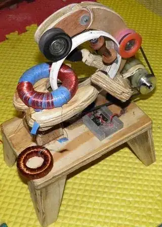

There is also a maker movement to create homemade toroid winding machines such as this one from http://www.instructables.com/id/Simple-Toroidal-Coil-Winder/:
