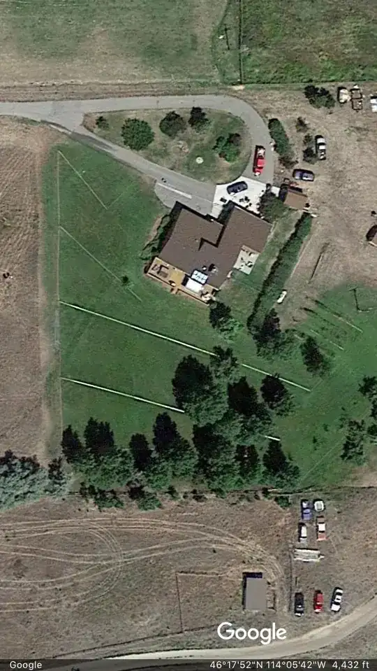

Could a aluminum irrigation system over about two acres work as a ground plane? Pros and cons? Shaped like an F but with 4 horizontals rather than 2.
irrigation system 2” pipe above ground
Sometimes it has water in it. The two top horizontals are 60 feet long, the bottom two are about 150 feet long. The feeder line on the left is also about 150 feet. Would it work and where would I connect the vertical Hustler antenna?

  • James, kindly describe the antenna that will be used over it, what band, and how deep the system is buried. A sketch with dimensions of the system as well as the antenna would also be very helpful. – Mike Waters Jun 10 '18 at 22:03
  • The Antenna is a hustler the irrigation system is above ground 2” pipe. The hustler can be hooked in the middle or end. The shape is a F with 4 horizontal runs each about 100 feet long parallel with 50 ft between. – James Uzzell Jun 10 '18 at 22:23
  • ————————————————- I————————————————- I————————————————- I————————————————l – James Uzzell Jun 10 '18 at 22:26
  • Just hook dots together with hustler bottom right corner – James Uzzell Jun 10 '18 at 22:36
    @JamesUzzell Please [edit] your question instead of putting the details in comments. It will be easier to read. – Kevin Reid AG6YO Jun 11 '18 at 01:28
  • How high above the ground are the aluminum pipes? Are the aluminum pipe sections electrically connected? – rclocher3 Jun 11 '18 at 16:32
  • Pipes are on the ground and they are hooked together so they would carry electricity – James Uzzell Jun 11 '18 at 22:56
  • I'm pretty sure I know the answer to your question. First, though, you'll have to describe your Hustler antenna in more detail AND what bands you prefer. A model number might be very helpful. – Mike Waters Jun 11 '18 at 23:45
  • The Hustler is old I don’t know model it is 21 feet tall. I use mostly 10 and 20 meters. – James Uzzell Jun 12 '18 at 13:51

Provided that the system is continuous metal pipe with no galvanic isolators, plastic couplings, plastic valves or other electrical discontinuities, the pipe should make a very good ground system for most HF antennas. The fact that the pipe is above ground is a real plus as this helps to minimize earth losses.
Keep in mind that if you plan a vertical HF antenna, the highest current density is in the area near the base of the antenna. Try to place the antenna near one of the tee pipe junctions so as to provide the best possible return path for the evanescent currents in the near field.
You can electrically couple to the aluminum pipe with a stainless steel strap. Make certain that no copper comes into direct contact with the aluminum - use stainless steel shims between the two. Some promote the use of copper to aluminum compounds such as DeOxIt that is used in electrical panels. This is not suitable for long term exposure to weather so it should not be relied upon in the long term. If you do use it, open the joint every year or so to inspect and reapply the grease based compound as needed.

  • Wow sounds great, I really appreciate your detailed answer!!!! I was going to use a woven stainless steel line with a radiator clamp. Thanks again! – James Uzzell Jun 12 '18 at 13:54
