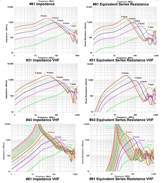

There is an excellent paper on the subject by Jim Brown (K9YC) ( http://audiosystemsgroup.com/RFI-Ham.pdf ). Unfortunately, his maximum frequency of interest is about 100 MHz and my application is VHF and UHF. [edit: this sentence is wrong]
The ferrite core manufacturers provide excellent information for impedance of a single turn at different frequencies. This can be used to estimate the impedance when using multiple turns, so long as the limit is not reached; that limit could be as low as 1 turn!

The K9YC paper you mention gives data up to 1 GHz on page 49:
These data show for these core types the maximum number of turns is just one or two. Furthermore, it's quite difficult to achieve a choking impedance above 1 kΩ. That's not very much, and for many applications you'd want more.
To get a higher choking impedance will require a larger core, and so ferrite chokes can become quite expensive at higher frequencies. For this reason it's often worth considering other techniques to supplement or replace them.

  • As much as I like this answer --especially correcting my misinformation-- I think there is more to it. I get the impression that smaller cores, in addition to making more efficient use of ferrite, have higher resonant frequencies. So to get a higher choking impedance, maybe it is sometimes advisable to use a smaller core along with a smaller wire (and 5-10 turns as per Laird). There was something along these lines in one of Snelling's books (either Ferrites for Inductors and Transformers or Soft Ferrites, Properties and Appications).but it did not sem important at the time. – Chris K8NVH Apr 15 '18 at 21:08
    As a postscript... I bought some small (0.125 inch ID) ferrite beads in #61 and #43 to see if the number of turns might be higher for any given frequency. They were not. Curves were close to what was posted here. – Chris K8NVH Jul 26 '18 at 02:04
  • A single turn is max? Is this why they frequently stack the beads on the wire? – user10489 Jul 26 '18 at 11:26
  • @user10489 A single turn is the max at VHF, so stacking a lot of beads is the only way to get more impedance. But when it's done at HF, I guess some people just have too much money. Or possibly they need (or think they need) a very wideband balun. – Phil Frost - W8II Jul 26 '18 at 11:50
