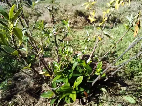

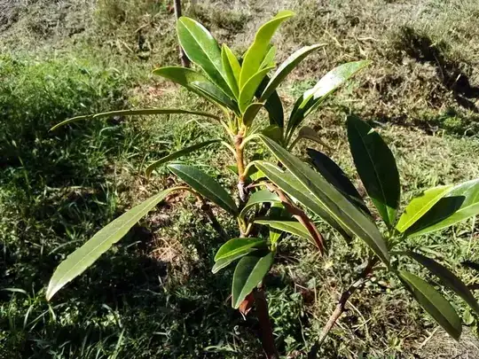

This spring I planted a narrow-leaved prunus laurocerasus (it could be Otto Lycken cultivar, but I am not positive). It started well and strong. However, the summer in my area was very hot and dry, and the plant was visibly shaken throughout summer months - a lot of leaves dropping, new leaves appearing. At some point it even bloomed, so it was strong, but still confused, and it still looks as if suffered a lot.
And about a month ago, a strange thing happened: New leaves started appearing from the base of the plant - and they are not narrow any more! They look like those from common prunus laurocerasus.
I have no clue what to do. Should I remove new leaves? Should I remove old leaves? Or should I just leave the plant as is and let the nature do the selection?
This is overall present look of the plant:
(branches used to be full of narrow leaves - now there are just some at the tops; at the center of the lant you can see new wide leaves)
Wide leaves at the base of the plant:
Narrow leaves at the top of the plant:

  • Are those grass clippings at the base of this plant? On one hand that would be the reason this plant got a boost of nitrogen, after the decomposers had had their fill of nitrogen to do the decomposition work. Gotta look at that trunk. If these clippings are decomposing you could also be looking at faster girdling/animal damage. Make a cleared circle at least the width of it's canopy width. You might have damaged trunks and vascular systems that would over ride fertilizer as a primary cause. – stormy Oct 12 '17 at 23:12
  • Does anyone notice the difference in margins on this one plant? – stormy Oct 12 '17 at 23:13
  • Yes, I put a thick layer of grass clippings around the plant in July, to prevent weed development, and keep moisture. The clippings are now mostly decomposed. @stormy – VividD Oct 13 '17 at 05:46
  • @stormy Leaf margin is different between the two types of leaves: the cultivar has smooth edges, while the base has serrated ones. This is fine, not unexpected. – VividD Oct 13 '17 at 06:29
  • Those clippings might have caused your bark to rot reducing the health of the vascular system. Undecomposed organic matter causes a loss of nitrogen as the decomposers will use the nitrogen first, the plant might get some after decomposition. Holding in moisture...as long as it is not touching that bark at all. Still robbing your soil of chemistry necessary to the plant. The two pictures I sent are of the same plant, one with serrated edges and one without. Have you added any balanced fertilizer? Ever? – stormy Oct 13 '17 at 23:41
Looks to me like those wide leaves are coming off of sucker growth from rootstock that your narrow leafed tree was grafted onto.
However, the main body of your narrow leafed tree doesn't seem to be dead, and looks like it will come back. My advice is to leave it alone for a while to make sure the main tree (upper portion)is completely on the road to recovery, and then trim off those wide sucker leaves at the bottom.

  • Some new growth can be even now definitely seen in upper parts, but a lot of leaves dropped since unbearable temperatures in August, so the plant looks terrible compared to its former look. – VividD Oct 12 '17 at 17:32
I agree that the wider leaved growth is coming off the rootstock, but you should remove it immediately,at the base, as close as you can get to the rootstock. Leaving that to grow will discourage the grafted part at the top from recovering and growing anew - growth off rootstocks is always stronger than that of the grafted part, and will take over and drown it out.
Perhaps you did not water the plant sufficiently well - any new shrub or tree planted in spring and throughout its first two years will need regular water supplies (from you, if its not falling out of the sky often enough) and copious, frequent amounts if the weather is very hot and dry for any time period at all. Prunus laurocerasus (the rootstock) is extremely resilient, but the grafted part not so much. Keep it well watered next year too. This plant does well in shade or part shade, so if you planted it in a full sun position, it will need more attention to watering for the next year or so from spring up to end of October (assuming you're in the northern hemisphere).
UPDATE: Having done some research, Prunus laurocerasus 'Zeblid' (which is likely what your plant is) seems to be simply a sport of P. laurocerasus rather than a grafted plant. If that's the case,then I'm sorry to say that some genetic reversion may have taken place, caused by environmental stress, which would mean you've now got P. laurocerasus growing from the roots, and not 'Zeblid'. If that's the case, then cutting back the reverted growth should, in theory, encourage the 'Zeblid' part to grow - but it depends how much damage has been sustained as to whether it works or not. I'd cut back the reverted growth because I'd rather have 'Zeblid' or some other replacement shrub, not being a fan of P. laurocerasus, but that's your choice to make.
