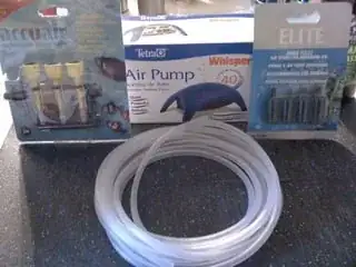

  • Materials bought from aquarium shop/outlet:
    • Aquarium pump - powerful enough to run the system you decide to set-up. I think the smallest pump my local aquarium shop sold was rated at "20 or 30 gallons" (76 or 114 Litre), but for only $2 to $3 more I decided to go with a slightly more powerful "40 gallon (151 Litre) pump".
    • Gang valve - 3 way.
    • 3 Bubblers.
    • 10 feet (3000mm) of tubing.
    • A reusable (fine) netted bag - after going through a few pairs of cheap stockings/tights, seeing as they're only good for one brewing process, I figured there must be a better way. I spoke with my local aquarium shop about my "peculiar" requirements, in fact they were fascinated by what I was doing, they suggested and got hold of a "reusable (fine) netted bag". I've now been using that bag for the past 18 months.
Below: 40 gallon aquarium pump, gang valve - 3 way, bubblers (4 pack) and tubing. (click image to enlarge)
Aquarium pump, 3-way gang valve, bubblers & tubing

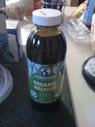

Below: Organic Molasses "Unsulfured". (click image to enlarge)

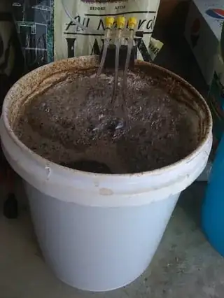

Below: Aerating water in a 5 gallon (19 Litre) bucket to remove chlorine, via 3-way gang valve, 3 bubblers and tubing connected to a aquarium pump. (click image to enlarge)
Aerating water in a bucket

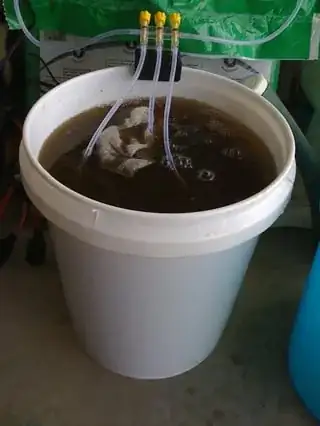

Below: Immediately after the reusable (fine) netted bag (containing the compost & earthworm castings mixture) and Molasses "Unsulfured" have been added to the aerated water in the bucket. (click image to enlarge)
Brewing Compost Tea
