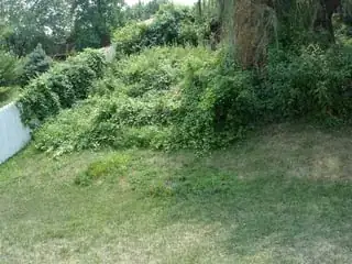

Here's my personal experience with seeding an approx 30° slope in our back-garden (back in 2008). We had to seed an area of approx 50 feet (15m) x 12 feet (3.5m) on a 30° slope.
August 2007, we started with this: (click image to enlarge)
Back garden overgrown slope
