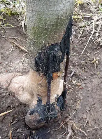

Bridge grafting may be the technique you're looking for. This method uses smaller stems to bridge the gap, allowing sap to flow across.
Tree saved from girdling by bridge grafting
Image credit found here, with directions on how to use this technique.
