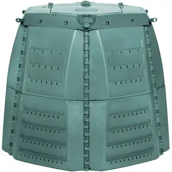

I want to start composting my yard and kitchen waste and use the compost to fertilize vegetables in my raised bed and some fruit trees I have. Right now I am not doing composting. My options are do nothing or use one of the smaller bins (pictures below) that are available through Costco or my city. The other option is to buy a larger composting bin (I heard 1m x 1m is the minimum). If that is the preferred option, can someone recommend a bin and whether it would be okay to keep that bin on concrete vs. having it sit on the soil. Dimensions of the City Compost bin is 28x28x30 inches
Costco Compost Bin City Compost Bin Another Costco Bin Geo Composting Bin

  • any thoughts on the green commercial bin in the picture above? It is large enough (compared to others) and avoids the risk of smell going out to neighbors (considering I am new to composting and live in a residential area). – JStorage Apr 07 '16 at 17:24
  • As a beginner, you should closely follow a working recipe to get good compost. Watch https://www.youtube.com/watch?v=W6cEUoN3NgI You note that you need all the ingredients available at that time to build the pile. That's incompatible with composting your kitchen waste in the pile. I bokashi compost my kitchen waste. Once you can do a proper pile, then you can decide whether it's worthwhile to use a bin which tends to make it easier to make mistakes, i.e. makes it harder to compost, but keeps it neat and tidy. – Graham Chiu Apr 07 '16 at 19:42
