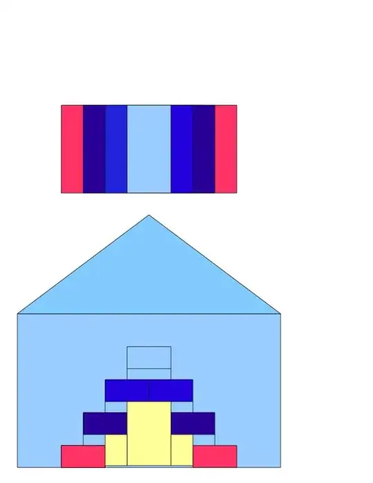

Obviously the sort of system pictured is not feasible for the average gardener, however, the use of vertical space is possible if you construct it properly.
The trick would be to construct a series of wooden planters that are offset so that the back edge of each planter gets sun while the sun is at a fairly low angle and then the next planter is constructed partially overhanging the lower one.
The key here would be to support each level well and probably to construct only a limited number of them across the sun's path in kind of a pyramid shape.
The other consideration would be to plant shaded or limited sun crops in the lower bins and full sun crops in the higher bins.
This may be too much of an eyesore for some neighborhoods, but if you live in an area with wide house spacing, or can do it on a rooftop then this seems like a setup that would work well provided it was constructed properly.
This is a crude drawing of what I'm thinking ofenter image description here. What I would do is use concrete in the yellow part in the middle then use cinder blocks or maybe even molded concrete blocks for the front end supports on each layer. This way I would not feel unsafe climbing up to the top of the beds (filled they should be heavy enough not to slide). I am unsure if I would build the top layer in my drawing or not.

  • nice drawing, that really sparks the imagination, I'd think you could probably suspend those planters from the roof of the structure as well, if it were solid enough - just make the interior ones thin enough to make room for chains going up to the ceiling from the lower ones. Do you have any idea what you'd use to line the bottom of the planters? – Peter Turner Aug 18 '11 at 14:43
  • I'm not sure. I haven't thought too hard about the actual planter construction yet. You don't water pooling up at the bottoms of the planters, so I would probably use something where drainage would be a possibility, but not sure how I would feel about trickle down. Maybe a perforated wood (or plastic?) bottom into a (plastic?) catch tray that fed a collection pool? – wax eagle Aug 18 '11 at 14:56
  • Wood bottoms won't last long at all. Galvanized hardware cloth lined with some kind of fabric might work for a bottom. Keep in mind that 6" of moist soil will be heavy -- a full 14x11x6" weighs 45 pounds. If your 2nd tier is, say, 8'x14"x6", you're approaching 400 pounds on each side, and that's just the soil. With concrete building materials, you're also adding a good bit of extra weight. – bstpierre Aug 19 '11 at 20:03
  • Is the idea to use the light blue square above the red but under the dark blue as a growing space? Or is this a filled/structural space? – bstpierre Aug 19 '11 at 20:09
  • @bstpierre that is open space – wax eagle Aug 19 '11 at 21:16
