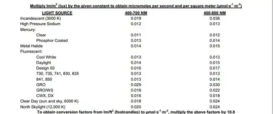

    • Despite containing some unfortunate "jargon" both the Sylvania reference mentioned below and the related Wikipedia page both contain tables with conversions factors to derive PAR Watts from more standard measures.
  • Enjoy
Here is a chart of conversion factors from the Sylvania reference:
