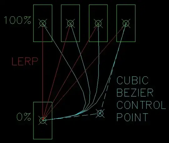

You are wanting to "lerp" between two Vectors, although I cannot tell you how to do it in AS3. The position will be based on a start-point, an end-point, and a % between the two. The % is usually a value of accumulatedAnimationTime divided by totalAnimationTime.
lerp diagram
You could also use a multiple of the % to spin the cards as they move into place, etc.
(in degrees) rotation = lerp(0, 1440, percent) //spins card 4 times while landing
currentPosition = lerp(start, end, percent) == (start + (percent * (end - start)))
The Bezier formula is only slightly more complex; worth a Google.
Edit: The Bezier in my image is cubic, except that the two intermediate points are coincidental. Using only 3 positions, you can reduce it to the quadratic Bezier formula.
float3 QuadraticBasis(float t)
    float invT = 1.0f - t;
    return float3(invT * invT, 2.0f * t * invT, t * t);
float3 QuadraticBezier(float3 input[3], float percent)
    float3 basis = QuadraticBasis(percent);
    return (input[0] * basis.x + input[1] * basis.y + input[2] * basis.z);
For a visual explanation, refer to the animations about 2/3 of the way down the Bezier wiki
