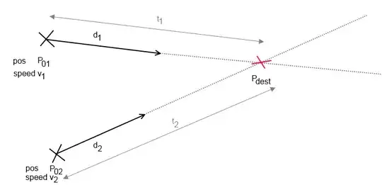

This is how I would pose the problem:
position equation: $$ \begin{align} P_{dest} &= P_{01} d_1 t_1 = P_{02} d_2 t_2 \\ t_1 &= P_{dest} / (P_{01} d_1) \\ P_{02} d_2 t_2 &= P_{01} d_1 P_{dest} / (P_{01} d_1) \\ t_2 &= (P_{01} d_1 P_{dest} / (P_{01} d_1) ) / P_{02} d_2 \end{align} $$
movement equation: $$ \begin{align} P_{01} + v_1 d_1 lapse_1 &= P_{dest} \\ P_{02} + v_2 d_2 lapse_2 &= P_{dest} \end{align} $$
Relationship: $$ \begin{align} v_1 d_1 lapse_1 = t_1 \\ v_2 d_2 lapse_2 = t_2 \end{align} $$
Then continue to substitute terms into each other until I find what I need.
Considering your question I think what you need is \$d_2\$. I guess the things you know are:
  • \$P_{01}\$, \$d_1\$, \$v_1\$
  • \$P_{02}\$, \$v_2\$
So try to make an equation that exhibits \$d_2=\$ only stuff you know from the set of equations in the drawing. That has to be possible.

v.oddou
  • 2,363
  • hmmm also I guess I realize all of a sudden, lol, but lapse1 == lapse2. yeah that must be. – v.oddou Mar 25 '15 at 08:01
  • Not sure how this helps, it rewording the question. What do you mean by ""? Both D1 and D2 are unknowns. – Sarke Mar 26 '15 at 07:35
  • you know d1, d1 is a unit vector in the 80 degrees direction. if you don't know d1, there is no solution, the system would lack one constraint. – v.oddou Mar 26 '15 at 08:52
  • Sorry, I misread d1 with t1, as Distance 1. So how do I solve this? And what do you mean by d2 = <only stuff you know> – Sarke Mar 26 '15 at 11:20
  • Also, I know for a fact there is enough information to solve this. I just don't know how. – Sarke Mar 26 '15 at 11:34
