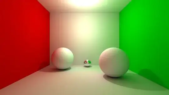

Ambient illumination, usually called Global illumination, which is light that bounces from one surface to another. For example, if you shine a bright white light on a flat green wall, that light will bounce off and illuminate the other walls in green.
enter image description here However, global illumination can be processor intensive, so...
