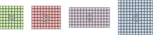

I'm making a game with a procedurally generated world created at the beginning of the game, consisting of several areas represented by grids (say, 8x8, 9x6, the sizes would ideally be arbitrary). These areas are supposed to be connected to each other through a dependency list.
A connection exists when at least 3 spaces of that grid are exposed between those two areas. In the middle cell of that 3 space connection area is the doorway between areas:
I've been trying to figure out a way to connect them, but it becomes increasingly complex the more areas you need to consider at the same time.
I've tried some paper prototyping and while it's a very simple process when doing it visually, I haven't found out a good set of mathematical expressions that allows me to place rooms with the same efficiency by code.
Here's a "simple" example I'm struggling with right now:
  • Area 'a' needs to be connected to 'b' and 'c'
  • Area 'b' needs to be connected to 'a' and 'd'
  • Area 'c' needs to be connected to 'a' and 'd'
  • Area 'd' needs to be connected to 'b' and 'c'
Consider, for simplicity, we're placing the rooms by their order of appearance on the list (I've tried others). So I'm approaching this as your standard procedural Dungeon Generation algorithm.
We place 'a' anywhere on the board, since it's the first area. Next, we pick a wall at random and, since nothing is connected to that wall, we can place 'b' there:
Now we need to place 'c', but 'a' is already on the board, and has an occupied wall, so we decide to put it on another wall. But not every placement will do, because 'd' is coming up and it needs to be connected to 'b' and 'c' too:
I tried a possible limitation that 2 rooms that have the same set of dependencies cannot be on opposite walls, but even that doesn't guarantee success:
And in other cases, where the areas have different sizes, being on opposite walls can work:
Also, not considering a used wall is a flawed assumption since it rules out valid solutions:
I've tried looking up research on other Procedural Generation algorithms or similar, such as Optimal Rectangle Packing and Graph Layout algorithms, but usually those algorithms don't take into account every constraint of this problem and are hard to mix together.
I thought about a bunch of approaches, including placing an area and backtrack until a suitable placement is found, but they seem very dependent on trial and error and costly in terms of computation. But, given the extensive research on the last two problems I mentioned, it might be the only/best solution?
I just wanted to see if someone has had similar problems in the past or is willing to help me figure this out and give me a few pointers on where I should start with the algorithm. Or, failing that, I'll have to look into loosening the constraints I've set.

  • The rooms have to be completely square? – AturSams Feb 14 '15 at 13:44
  • If you mean if they have to have 4 walls and not more then yes, but I did that to simplify the world space. I need to easily calculate the space each area occupies so I know if I will be able to put everything I want on it. – Joana Almeida Feb 14 '15 at 15:51
Your generation priorities are in conflict. When generating levels, your first goal should be a web of planar (non-overlapping), connected points, irrespective of scale. Then proceed to create rooms from the points within that web. Creating room shapes first is a mistake, generally speaking. Create connectivity first, and then see what room forms can be accommodated within that.

This is a cool problem. I believe it can be solved using action planning in the space of room placements.
Define the State of the world as follows:
//State:
//    A list of room states.
//    Room state:
//      - Does room exist?
//      - Where is room's location?
//      - What is the room's size?
Define a Constraint as:
 // Constraint(<1>, <2>):
 //  - If room <1> and <2> exist, Room <1> is adjacent to Room <2>
Where "adjacent" is as you described (sharing at least 3 neighbors)
A Constraint is said to be invalidated whenever the two rooms are not adjacent, and both rooms exist.
Define a State to be valid when:
// foreach Constraint:
//        The Constraint is "not invalidated".
// foreach Room:
//       The room does not intersect another room.
Define an Action as a placement of a room, given a current State. The Action is valid whenever the resulting state from the action is valid. Therefore, we can generate a list of actions for each state:
// Returns a list of valid actions from the current state
function List<Action> GetValidActions(State current, List<Constraint> constraints):
    List<Action> actions = new List<Action>();
    // For each non-existent room..
    foreach Room room in current.Rooms:
        if(!room.Exists)
            // Try to put it at every possible location
            foreach Position position in Dungeon:
                 State next = current.PlaceRoom(room, position)
                 // If the next state is valid, we add that action to the list.
                 if(next.IsValid(constraints))
                     actions.Add(new Action(room, position));
Now, what you're left with is a graph, where States are nodes, and Actions are links. The goal is to find a State which is both valid, and all of the rooms have been placed. We can find a valid placement by searching through the graph in an arbitrary way, perhaps using a depth-first search. The search will look something like this:

Now the quality of the dungeon generated will depend on the order in which rooms and actions are considered. You can get interesting and different results probably by just randomly permuting the actions you take at each stage, thereby doing a random walk through the state-action graph. The search efficiency will greatly depend on how quickly you can reject invalid states. It may help to generate valid states from the constraints whenever you want to find valid actions.
mklingen
  • 3,627
  • 27
  • Funny you should mention this solution. I talked to a friend earlier and he mentioned that I should probably look into Tree Based Search algorithms, but I wasn't sure how to use them in this context. Your post was eye opening! It certainly seems like a feasible solution if you manage the branch generation and do a few optimizations to cut bad branches as soon as possible. – Joana Almeida Feb 14 '15 at 15:53
