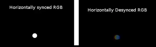

My plan is to achieve analog video effects like RGB channel desynchronisation.
I'd like to have something like this (I hope you get the idea): My effect - This one i manually made with gimp Left: White dot; Right: The same dot, but mind the channel offsets (the center should be brighter and white).

  • So your actual goal is to implement the effect shown? –  Feb 09 '15 at 22:27
  • @JoshPetrie exctly. and some other like RGB noise, bad VSync, i hae some ideas for code, and i think i could achievethem if i could get to the display data like one could do in a fashion of poking values into mem adresses bound to video on devices like C64 etc. – thekiwi5000 Feb 09 '15 at 22:31
  • Well, you can't get the display data directly on modern hardware, and LWJGL is just an OpenGL wrapper. You can get a copy of the GL backbuffer's pixel data, but updating and copying it back is slow. Better to do this in a shader instead. –  Feb 09 '15 at 22:35
  • This type of effect is commonly known as "chromatic aberration" - you should be able to find shader examples by searching on that name. – DMGregory Feb 09 '15 at 22:40
