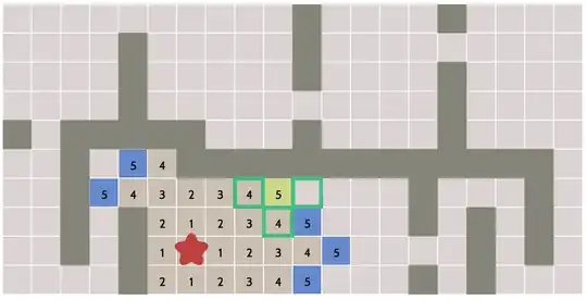

Breadth First Search can calculate every location reachable from a start position, and it can also count how many steps to that location. (If some steps take more "moves" then use Dijkstra's Algorithm instead). See the fourth demo on this page. You would tell the algorithm to stop after some number of moves, so that it doesn't keep exploring the rest of the map. In this image I stopped it after 5 steps:
Breadth first search limited to distance 5

  • Love your tutorials, thank you for them. My Dijkstra's/BFS alike solution here - https://gamedev.stackexchange.com/a/195239/93428 . At first I thought that Dijkstra's needs a priority queue, so Dijkstra's is basically BFS but with weighted nodes, am I correct? – Candid Moon _Max_ Aug 15 '21 at 02:08
    Yes, Dijkstra's is BFS is weighted nodes. The two main changes are the use of a priority queue, and the possibility that you visit a node a second time with a lower cost, so you need to put that node back into the priority queue. With BFS the first time you visit a node it's the best path so you never need to put it back into the queue a second time. – amitp Aug 15 '21 at 15:19
