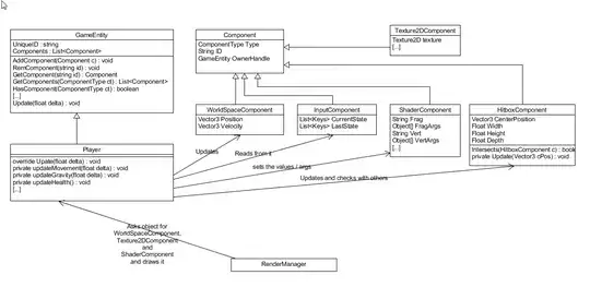

Update
After reading the Answer from Nick, I did a quick UML-likish diagram to clearify if I got the idea/structure right. The diagram is just an example with a pseudo UML-like diagram an some pseudo example constelations. The Idea is, that the concrete composition objects holds and treats their component as a data structure. They set it, alter it, and read from it to do it's logics. They also can compare Components of other concrete objects for convience and provice their components to higher systems (like managers)
pseudo uml like diagram
Update 2 After some discussion and a bit of confusion due opposites arguments, I started to google with new keywords I got from the comments and found an article which helped me understand how the system is glued together.

  • Thank you for the link, I already read that article two days ago (besides other articles). So, you mean that I should treat the Components as a Data-Object without any logic? So at this hirarchy: Concrete Object Player has X Components as pure data, the logic of how the data will be processed decides wether the Object it holds or a separate system like a manager? e.g. concrete object Player has the logic for setting the current animation or alter the AnimationComponent data but RenderManager has the logic for actually drawing the current animation and reads it from the concrete Player object? – Ello Nov 10 '14 at 12:08
  • @Ello Yes, You have it. There is nothing wrong with keeping functions / logic on the entity itself (as then you have the benefit of accessing local data using this, but this approach is only appropriate where you do not need batch processing / overarching context as in the example I described above. – Engineer Nov 10 '14 at 12:50
  • Thank you @Nick Wiggill, I edited my original question and added a diagram to verify I got it right. – Ello Nov 10 '14 at 12:57
  • @Ello Your UML has a couple of mistakes: your RenderManager should reference one more more lists of Entity. Likewise should not be inheriting Player from Entity -- this is the whole point of CBEs -- no inheritance! You want generic lists of Entitys that are processed selectively based on their properties. So compose a player given the Entity structure, don't inherit to create one. What composes a player different from an AI? It replaces an AI control module with a human control module that interfaces with input devices, instead. Other components are as an AI Entitys might be. – Engineer Nov 10 '14 at 13:40
  • Ok @Nick Wigill now I got it, I guess. I did the inheritance from Entity because I wanted to provide a unique accessing way to get the components. But I guess I will create a new Entity object instead name it Player and add Components on runtime to it. The logic I will do with scripts? – Ello Nov 10 '14 at 15:07
  • @Ello I believe what Nick was suggesting is that you have a separate class called 'Player' that has a variable of 'GameEntity'. This player class acts as an abstraction layer around the 'GameEntity' and component system for player-specific functionality. – Naros Nov 10 '14 at 15:43
  • @crancran No, that's not what I was suggesting -- I explicitly said to avoid subclassing. @Ello Give it an id, type, set up as you wish, but don't lock into anything by inheritance. You may keep a separate list of Entitys that represent players so that top level logic can access these quickly from time to time, but keep all entities generic enough to be processed from a single list by any part of your game logic, special cases to be handled inline through (non-reflective) conditionals. This avoids restrictive hierarchies and costly class reflection. If at all, inherit at component level. – Engineer Nov 10 '14 at 17:19
  • @NickWiggill I found this article link, I guess I know understand how everything is glues together. I will mark your answer as it helped me find the correct way. – Ello Nov 10 '14 at 20:18
