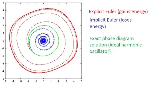

If you want to understand what are the differences between symplectic/energy conserving integrators, explicit and implicit ones, you need to look no further than to how the phase diagrams look like: http://www.acs.psu.edu/drussell/Demos/phase-diagram/phase-diagram.html . For simple oscillators (e.g. the pendulum), these are 2D plots of the angular value against the angular velocity. enter image description here If the integrator preserves energy, the phase diagram will basically look like an ellipse, whereas if the integrator loses or gains energy, the phase diagram will resemble a spiral.

  • thanks for the excellent answer. I only what to understand how I can understand if integrator conserves energy or not. Is there a simple method? – Narek Oct 30 '14 at 13:00
  • I updated my answer to include a brief explanation about what the main properties of different integration strategies are (phase space area conservation = symplecticity = energy preserving and *implicit = unconditionally stable due to "cautious" update steps that result in both energy loss or undershooting the exact solution on the phase diagram plot orbit). – teodron Oct 30 '14 at 14:09
