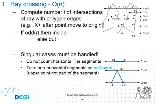

Second (circle is whole in polygon): Shoot ray from circle center to the right (or left/up/down) and count ray/segment (polygon edges) intersections. If intersection count is even circle is outside of polygon. If it's odd circle is inside.
I'll share picter from lectue for this case:
And take care of the singular cases.
Hope this will help.
edit: I think that it is just fair to add credits to the picture. Author is Petr Felkel, Assistant Professor at Czech Technical University in Prague

  • I don't think this will work by just "shooting" a ray to the right. Maybe I misread your approach, but from what I understood it would fail with a setup as depicted here: http://imgur.com/Whg2u – bummzack Jan 26 '11 at 12:59
    Yes but this is described in the first case. Shooting ray will solve only the Polygon containing circle (second case in my description). You have to test both cases. It is fast, easy to implement and do not need any memory. – Notabene Jan 26 '11 at 13:02
    I'm sorry I confused "edge" with "vertex" and therefore misinterpreted your first check. When reading it correctly, it works :) – bummzack Jan 26 '11 at 14:04
