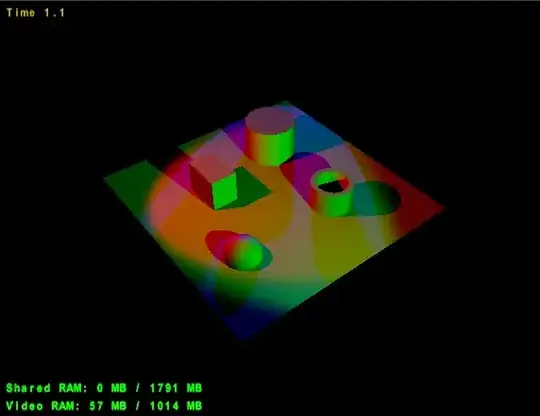

Edit: To prove my point, i added two renders, because this technique sometimes sounds weird. One is rendered with gpu renderer which using described technique. And second is same scene rendered with Maya. Scene is lighted with 3 lights. One emits red, one blue and one green color. Common shadow mapping is used.
Realtime renderer:
furryball

  • That's some pretty sweet screenshots. I think this has got to be the accepted answer. – DeadMG Jan 24 '11 at 14:23
  • So just to be sure: Render the scene from the perspective of a light to a texture, phong shade and blend to backbuffer, repeat for each light but ignore material. – DeadMG Jan 29 '11 at 22:18
