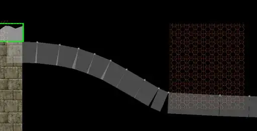

For a Peggle-like game, I want to make blocks that follow a curve, like this:
blocks along a curve
The blocks would then disappear as the ball hits them.
I managed to draw some horizontally, but I'm having trouble making them follow a path:
my attempt at path-following blocks
How do I do this? Do I need to create Box2D objects with custom vertices?

  • Do you want the boxes to simply not overlap or do you want there to be no gaps anywhere? (I'm not exactly sure what you mean by "offsetting the object Y axis according to the object angle"). – Roy T. Feb 19 '14 at 14:51
    You can't fill a curve with non-overlapping rectangles, so you're going to have to create some custom geomety if you want no gaps. – Anko Feb 19 '14 at 14:58
  • @RoyT. The gaps aren't important. My real problem is to compute the position of the block which follow each other with different angle. – Moerin Feb 19 '14 at 15:11
  • The way I would approach this is to define a series of vertices that act as the common corners between each box. Even using a path to define them, you still need additional parameters to define the distance between the vertices and how long each box is. –  Feb 19 '14 at 15:19
  • @Anko Yes, it's a solution but it'll be more difficult to create object with custom vertices. – Moerin Feb 19 '14 at 15:19
  • @Thebluefish It's a good idea. I thought at a same thing with the help of Pythagore Theorem. If you have the box width, the angle and the length between two vertices, you can find the last side wich would be the Y offset for the top-right box coordinate if we refer as the last pictures. But i have no idea how to implement it. – Moerin Feb 19 '14 at 15:33
    The "boxes" on the first image are not boxes, they are pairs of triangles: http://i.stack.imgur.com/Tzuql.png – egarcia Feb 19 '14 at 15:46

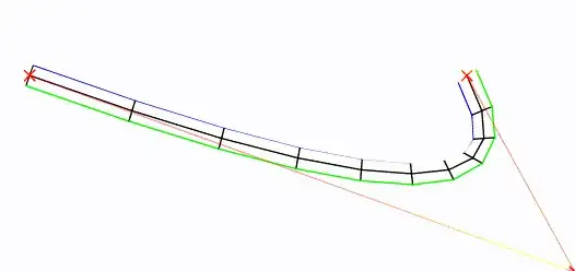

Given a "root" curve, here's how you might generate block vertices.
Bézier with blocks
The root curve is in the middle, in black. Its control points are shown with red Xs.
In short: I made a Bézier and sampled it (at a configurable rate). I then found the perpendicular vector of the vector from each sample to the next, normalised it, and scaled it to to a (configurable) half-width, first to the left, then inversely to the right. Then drew it.
Stuff you could add to this:
Here's my code. It's written in Lua (for the LÖVE game framework), but I think it's readable for anyone.

If you'd like to play with it: Get LÖVE and put the above code into main.lua in its own directory. Put vector.lua from the HUMP library in the same directory. Run it as love <that-directory> from a command line.
Move the mouse around! The middle control point is set to the mouse location:
Setting control point with mouse
