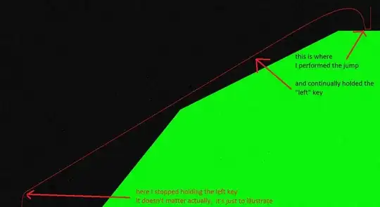

To illustrate this, this is how the flight curve looks like for my character if I jump and continually press the "left button" (it looks different at the left end, this is where I was making some manuevers in mid-air): enter image description here
The force applied during flight is always parallel to the X axis, so it is F = (-f, 0) if I hold "left" and it is F = (f, 0) if I hold "right".

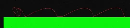

He can move very much like a ski jumper:

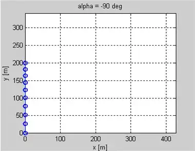

So it differs a lot from the classic trajectory which is simply a parabola (source: wikipedia):

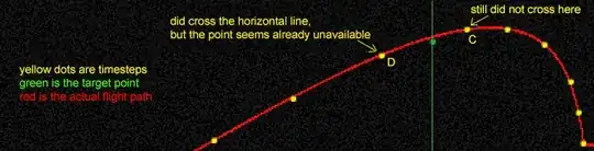

edit: I've decided to solve this using simulation as Jason suggests, but how to handle such a case? enter image description here
Should I draw a segment from C to D and check whether the desired point lies below this segment?
Or should I binary search the timesteps between C and D to look for the point that is close enough in horizontal distance to the desired point, and only then check the vertical difference? (seems a bit overkill to me)

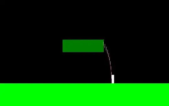

Yay! I did it!
I'm using simple simulation that takes the first position to land behind the vertical axis of the target point - from there, I take the previous simulated position and make a segment. Now I check whether the target point is below this segment. If it is - we can jump there.
It's a player-controlled character on the gif. Pink is the predicted path, yellow segments are predicted subsequent stepping positions, and the final segment turns white if the target point lies below it, red otherwise. Red curve is the actual flight path. There are some slight inaccuracies due to physics state interpolation turned on.
The calculations turned out to be surprisingly easy, however making my environment work the same way as these pure calculations do... was a massive pain in the butt. At least I solved some serious bugs out there, so it was a useful exercise after all.
