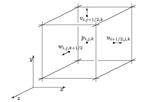

The usual approach to represent realistic 3D fluids is to use a cell-based representation of the tracked portion of the world in which the fluid will be confined. Each cell has the velocity and pressure info, as shown in the image bellow. Instead of tracking the fluid in the world (Lagrangian viewpoint), the grid give us the possibility of look at fixed points in the space, the cells themselves (Eulerian viewpoint), which turns the problem easier to tackle.
Grid cell.
Grid cell. p is the pressure, u, v and w are the velocity components for each axis.

The pressure contribution is the most difficult, since usually it is also used to enforce the incompressibility condition and boundary conditions. It can be shown that the pressure solving leads to a Poisson equation, resulting in a linear system. To solve this equation the Modified Incomplete Cholesky Conjugate Gradient Algorithm can be used. It is fast but difficult to parallelise and implement. On the other hand, the Jacobi iterations are easy to implement and parallelise, so they are being used in shader implementations of fluid dynamics.
With this kind of representation the collision response for fluids comes practically for free, because of the advection and pressure updates. You just need to make sure that all fluid is inside the controlled world space.
