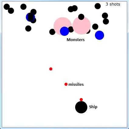

I am working on a 2d arcade game where I have 5 types of circles with different sizes: The ship, the missiles, and 3 types of monsters.
This is what it looks like:
Currently I'm using brute force collision detection where I check every missile vs. every monster without taking probability of collision into account. Sadly, this makes the process REALLY slow.
This here is my Grid class, but it's incomplete. I'd greatly appreciate your help.

Given the image depicting a very manageable number of spheres you shouldn't have any problem checking every missile against every enemy.
You haven't shown us the relevant code, but my best guess it that you are not using basic sphere-to-sphere collision detection like you should.
Basically every sphere has a centre position and a radius. For every pair of spheres, if the distance between the centres is less than the sum of their radii the spheres intersect, otherwise they don't. If you implement this method right there should be no need to worry about performance unless you need to do a million or more checks per frame.
