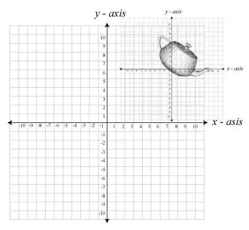

Disclaimer: I am not a physics expert, neither I guarantee the following explanation to be entirely accurate, but I will try to make things simpler.
First: Let's us break it down into two keywords, obviously space and interia.
Space (or a frame of reference) in 3D : is a combination of rotation and translation. So when we say a point is relative to a specific space, we mean that its coordinates are measured relative to that space orientation and translation. More on this here.
When you measure temperature you measure it relative to a certain reference (could be the zero or other value in your thermometer). When you say 10C you mean 10°C relative to 0°C where 0°C was defined as the freezing point of water. (Note: This is not entirely accurate more info here.
The same goes for bodies motion, we measure them relative to something else, whether it was an observer space or any other body space.
