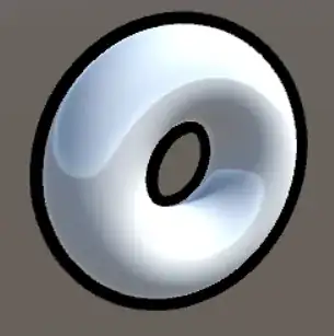

One of the ways to make an outline is to use our models normal vectors. Normal vectors are vectors that are perpendicular to their surface (pointing away from the surface). The trick here is to split your character model into two parts. The vertices that are facing the camera and the vertices that are facing away from the camera. We will call them FRONT and BACK respectively.
For the outline we take our BACK vertices and move them slightly in the direction of their normal vectors. Think about it like making the part of our character that is facing away from the camera a little fatter. After we have that done, we assign them a color of our choice and we have a nice outline.
Shader "Custom/OutlineShader" {
    Properties {
        _MainTex ("Base (RGB)", 2D) = "white" {}
        _Outline("Outline Thickness", Range(0.0, 0.3)) = 0.002
        _OutlineColor("Outline Color", Color) = (0,0,0,1)
CGINCLUDE
#include &quot;UnityCG.cginc&quot;
sampler2D _MainTex;
half4 _MainTex_ST;
half _Outline;
half4 _OutlineColor;
struct appdata {
    half4 vertex : POSITION;
    half4 uv : TEXCOORD0;
    half3 normal : NORMAL;
    fixed4 color : COLOR;
struct v2f {
    half4 pos : POSITION;
    half2 uv : TEXCOORD0;
ENDCG
SubShader
    Tags {
        &quot;RenderType&quot;=&quot;Opaque&quot;
        &quot;Queue&quot; = &quot;Transparent&quot;
    Pass{
        Name &quot;OUTLINE&quot;
        Cull Front
        CGPROGRAM
        #pragma vertex vert
        #pragma fragment frag
        v2f vert(appdata v)
            v2f o;
            o.pos = mul(UNITY_MATRIX_MVP, v.vertex);
            half3 norm = mul((half3x3)UNITY_MATRIX_IT_MV, v.normal);
            half2 offset = TransformViewToProjection(norm.xy);
            o.pos.xy += offset * o.pos.z * _Outline;
            o.color = _OutlineColor;
            return o;
        fixed4 frag(v2f i) : COLOR
            fixed4 o;
            o = i.color;
            return o;
        ENDCG
    Pass
        Name &quot;TEXTURE&quot;
        Cull Back
        ZWrite On
        ZTest LEqual
        CGPROGRAM
        #pragma vertex vert
        v2f vert(appdata v)
            v2f o;
            o.uv = TRANSFORM_TEX(v.uv, _MainTex);
            o.color = v.color;
            return o;
            fixed4 o;
            o = tex2D(_MainTex, i.uv.xy);
            return o;
        ENDCG
Line 41: The “Cull Front” setting tells the shader to perform a culling on the front facing vertices. It means that we will ignore all the front facing vertices in this pass. We are left with the BACK side that we want to manipulate a little.
Lines 51-53: The math of moving vertices along their normal vectors.
Line 54: Setting the vertex color to our color of choice defined in the shaders properties.
Useful Link: http://wiki.unity3d.com/index.php/Silhouette-Outlined_Diffuse
