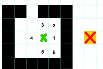

I tried to follow this article with the following example, but in my attempts it always ends up with a dead end.
If we take G being 10 in a straight line or 14 in a diagonal, and H the distance in horizontal or vertical to the target point, then we restart this search for every tile that is the nearest one to the target point.
I have this result: if we take one or the other direction with 54, it ends up with a dead end. For example, if we go up from 40 to 54, then to 60, when we restart the search with G and H, it ends up with "4" (second shema) and comes back in a dead end:
Why does this happen and how can I solve it?
I also looked at the wiki, but I did not understand the system with the colors and the code shown.

  • From the way you describe your algorithm, you only have one active open path. A* creates a path going each direction at each node and stores them in a list then repeats the process for the lowest path until it finds the end. – UnderscoreZero Dec 05 '13 at 16:31
  • @UnderscoreZero what if you the path arrives at a dead-end, how to know until which node to come back? – Paul Dec 05 '13 at 17:17
    @Paul You seem to misunderstand A*. There's no single "path" and you don't go backwards when you hit a dead end. You just have a list of candidate tiles and you always expand on the one with the lowest cost. The path is only built via backtracking when you actually hit the target node. Maybe this helps: http://gamedev.stackexchange.com/questions/15/how-does-a-pathfinding-work/23760#23760 – bummzack Dec 06 '13 at 07:56
  • OK, thanks for the link! I added an answer below, thanks for your help – Paul Dec 06 '13 at 16:44

You don't really backtrack.
Think of A* as having an outer “fringe” of nodes that it wants to consider (also called a “frontier”). This is the OPEN set. At every step it picks one of these and expands it, and moves that node into the CLOSED set. The ever-expanding fringe surrounding the start node will eventually eat up the whole map if you let it.
What you think of as backtracking is A* first expanding the fringe to the right, hitting a wall, and being unable to expand in that direction. But the rest of the fringe is still there. A* will expand other parts of it. It should eventually fill the interior room and go out the door to the north. Once it does that, it'll expand eastwards and then southwards until it reaches your goal.
A* expands its fringe until it exits the room

  • thanks @amitp, can I ask you a question? When it reaches a dead end, we should not let the pink button restart the same path and come back to the dead end, but... how to let him know that the previous path was wrong, and still use the same first squares to take this time another path? – Paul Dec 06 '13 at 07:12
  • @Paul the open set holds all potential paths so when the current node can't go on any more, it can select another node and continue with that one – ratchet freak Dec 06 '13 at 07:27
you need to backtrack when you encounter a dead-end
the stock standard path search algorithm is:
Closed =[]
Open =[start]
while true
    current = select and remove a node from Open
    add current to Closed
    if current is goal return
    for each node a that neighbors current
        if a is not in Closed
            add a to Seen (or update a in Open)
the first line in the while is what differentiates all the algorithms from each other:
  • in breadth first you select the node that has been there the longest (FIFO)
  • in depth first you select the node that has been there the shortest (LIFO)
  • in dijkstra you select the node with the lowest cost (this is G in the tutorial)
  • in A* you select the node with the lowest cost+expectedCost (this is F in the tutorial)
if your map is finite then all variants will find a path eventually or fail only if there is no path
one mistake that I see here is that your heuristic (you expected cost) is not strictly underestimating (going diagonal costs 14 while the heuristic says it costs 20) this will make A* not behave correctly (it will still find a path but not necessarily the best one)
the nodes I expect A* to select are
  1. startnode where it sets node 1 to 40, node 2 to 54, node 3 to 60, node above 4 to 74, node 4 to 80, node below 4 to 74, node 5 to 60 and node 6 to 54. adding them all to open
  2. node 1, where it can't update anything
  3. node 2, where it also can't update anything
  4. node 6, ditto
  5. node 3, where it would add the node in the gap with value 94 (cost 24 + heuristic 70)
  6. node 5, where it can't update anything
and so on, the fact that you never get to the gap in the wall means that something is wrong in your logic, like not not including some neighbors
ratchet freak
  • 7,246
  • thanks ratchet, I wrote node 4 and above as if we were on node 3, after we passed through 1, 2 and arrived to 3. In your example, when do you restart the search for each tile? In my mind, it starts again each time it switches the current to a new tile (with a lower value), which makes it turn around the green cross. (And, how do you find 80 for node 4? +10 for G, and +6 * 10 for H, F = 70 ? (I wrote 64 instead of 70, because I compared it from node 3) – Paul Dec 05 '13 at 17:29
