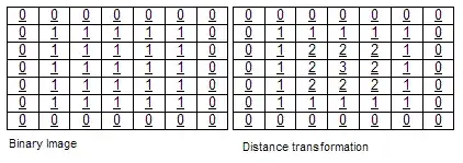

The above image contains a Distance map for boundary pixels. Notice how each pixel contains the distance to the nearest boundary pixel. The distance is calculated using Manhattan distance.
