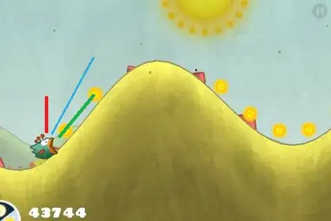

The physically "correct" way (vertical impulse)
To jump, you add a vertical impulse (red) to your movement velocity (green). The resulting velocity (blue) will always take you above the slope, so as long as your slope doesn't get too much steeper soon, your character will always jump above the slope.
tiny wings
The caveat is that if your character is racing up a steep slope, you can now jump up very high.
