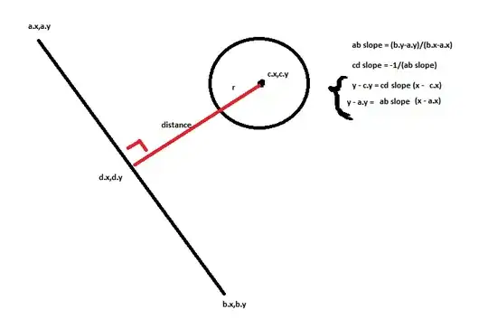

You want to measure the distance between the center of your ball and the wall, so:
solving the system that you see in the picture will give you the coordinates of point d.
Then, if the distance between point d and c is smaller or equal to the radius of the ball r, there is a collision between the ball and the wall
