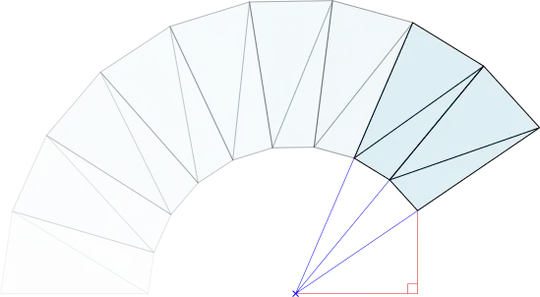

Use trig to sample it into a triangle strip.
fan sampling
As for texturing: a rectangular image UV-mapped to the triangle strip might work, with projective interpolation.
