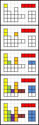

*Edit: I have implemented my own little technique, which probably has a name, but I simply go through my 6 lists which are sorted by the axes they rest on, followed by block type, and then by lighting level. I iterate through them, creating new rectangles as I go and grow them simultaneously (with a heavy bias towards a certain axis). It is definitely not optimal, but it is indeed quite fast and it does lower my vertex count by close to 50% on average. Byte56's comment is the closet I think to a real answer, but I can't select that for the answer/bounty.
Here is my fast and simplistic way I'm handling this problem AFTER generating the full initial terrain without much of any optimization. Assuming all squares given are the same image, light level, normal, etc.. each color is a different quad I would render. With my lists sorted the way they are, this is a very easy/fast approach.

    Ah, OK Tim. Thanks for the explanation. I did some research into this when I was making the engine for my game. Since my landscape is dynamic, I didn't think it would be worth the performance cost every time something was changed. However, you may find some use from this article about the maximal rectangle problem. Essentially it's the algorithm you're talking about for merging similar faces (maybe not greedy, but optimal). Good luck! – House Jul 03 '13 at 15:03
  • @Byte56 Thanks, I greatly appreciate it. That certainly looks closer to the kind of algorithm I'm looking for, if not spot on. I'll have to tinker with it a bit to see if I can get all maximum rectangles with a single run of it. I may throw a bounty up for this as well in a bit as I think both the question and a detailed answer could help many others in the future. – Mythics Jul 05 '13 at 13:50

The article that you link to doesn't actually give an algorithm for generating the mesh; it states a way to evaluate possible solutions.
Generally, though, the article gives a good summary: 1) the naive solution is bad, 2) there's an optimal solution, but it will be both time-consuming to write and to run, 3) a quick culling gives much better results (and this is all Minecraft itself does), and finally 4) there might be a smarter solution (the greedy algorithm).
The "solution" that you imply in the image in your question is the greedy algorithm. It seems your question is "did I implement his solution correctly?" to which I must answer "he didn't give a solution; you just solved this yourself."
