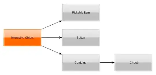

To throw some examples in, this is actually a class inheritance map (one that's been cut) in my game where Interactive Object is the base type.

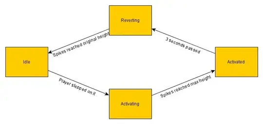

This is an FSM (Finite-state machine) diagram for a spikes trap (those awesome traps on which you step and woosh spikes show up from the ground).
FSM diagram for a simple spike trap

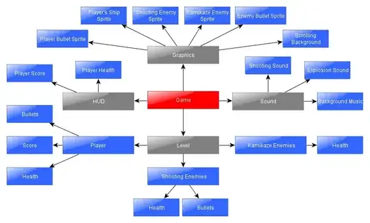

This is a handbook diagram (named this way because it's intended to be a come back to it often diagram) that I drew recently. It outlines the components of a game, and also helps with gathering the required assets, as you can see immediately what's needed and what isn't. I recommend these on small projects, as they get pretty huge on big ones. They can be broadened further though, so that may fix things.
Game overview

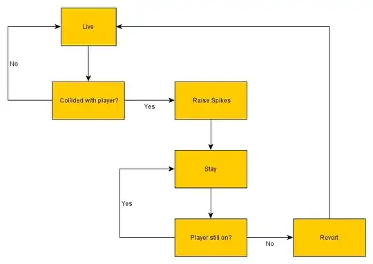

Another situation when I have to go to a lower level is when I have to describe actual algorithms. I use what I call flow diagrams. It is a format inspired by the diagrams used in white box testing.
A sample for the spike trap that I drew right now would look like this: More detailed spike trap flowchart
This is normally the final layer between diagrams and actual algorithm implementations. If the need arises, I detail the flow diagrams further (with extra executed instructions), and deduce or estimate complexity, and build accurate test cases. I also prefer diagrams over pseudocode.
