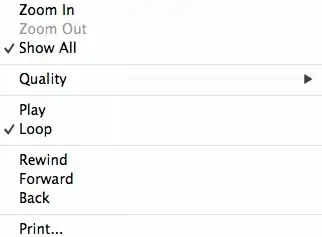

How can I disable the Flash player forward and back button in AS3? These buttons make it possible to cheat in my game by moving from level to level.
I guess you're referring to the default entries in the Flash-Player menu:
flash player menu
The entries there can be customize (to a certain degree) by using the ContextMenu class.
Here's an example. In a frame of your timeline (preferrably at the beginning), place the following code:
var menu:ContextMenu = new ContextMenu();
var items:ContextMenuBuiltInItems = new ContextMenuBuiltInItems();
// disable the undesired items from the built-in items
items.play = false;
items.rewind = false;
items.forwardAndBack = false;
menu.builtInItems = items;
// override the context menu with our own menu
this.contextMenu = menu;
