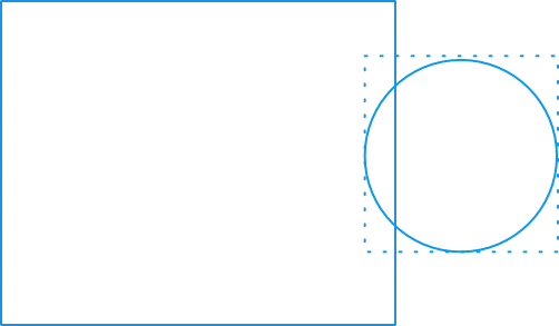

The code that you are using does not check for the collisions from right and bottom side, it only checks when the ball collides from top left side.case 1case 2
For this case the above code fails to check for a collision
case 3
take a look at this code its just basic detection not very accurate but you should get the point. Hope this helps.
if (ballLocation.Center.Y > BrickLocation.Y && ballLocation.Center.Y < (BrickLocation.Y + BrickLocation.Height))
                if (BrickLocation.Center.X > ballLocation.Center.X)
                    velocity.X = mod(velocity.X) * -1;
                else if (BrickLocation.Center.X < ballLocation.Center.X)
                    velocity.X = mod(velocity.X);
            else if (ballLocation.Center.X > BrickLocation.X && ballLocation.Center.X < (BrickLocation.X + BrickLocation.Width))
                if (BrickLocation.Center.Y < ballLocation.Center.Y)
                    velocity.Y = mod(velocity.Y);
                else if (BrickLocation.Center.Y > ballLocation.Center.Y)
                    velocity.Y = mod(velocity.Y) * -1;
