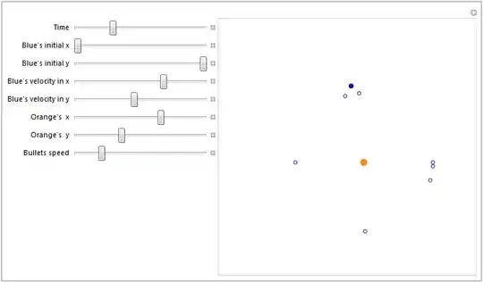

I've grown some interest for this question, so I've created a commented notebook with a graphical demonstration of everything I explained . Download it here:
http://www.2shared.com/file/pXhYyhN1/towerBullets.html
Or here: http://www.2shared.com/file/W01g4sST/towerBullets.html
(this is the published version, and you only need the mathematica player -which is free- to see it. If you don't have mathematica this is the way to go)
Screenshot:
