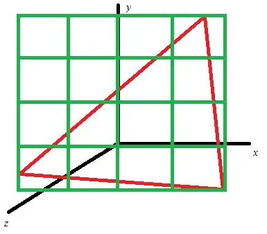

I have a triangle in 3d space and would like to create a grid over the triangle, such as in the image below.
The purpose of this is to store information about each block of the grid. In order to store this grid in a 2D array, my idea was to rotate the triangle until it is in the XY plane. After rotation the above triangle would look like the image below.
What I have tried to do is find the angle between the triangle's normal and the z-axis, then rotate each vertex by this amount.

The result of this code would be:
Triangle's normal: (0.0, -50.0, 50.0)
Normalized normal: (0.0, -0.7071067811865475, 0.7071067811865475)
Vertices after rotation:
   (0.0, 0.0, 0.0)
   (4.440892098500626E-16, 7.0710678118654755, 5.0)
   (-7.0710678118654755, 4.440892098500626E-16, 5.0)
This is not quite right, though. I am expecting all z-coordinates to be the same so that I can ignore them and store the grid in a 2d array. Is there something else I need to do to rotate the triangle appropriately, or is there a simpler way to store this grid? If needed, the code for my rotation matrix is below:

The rotation-axis is not the z-axis, it is the cross product of the normal of the triangle and the z-axis:
rot_axis = normalize(cross(axis_z, triangle_normal))
the rot_angle that you already calculated:
rot_angle = acos(dot(axis_z, triangle_normal))
Now we have the Axis-Angle of the rotation. You can convert it to a matrix using Matrix4x4::CreateFromAxisAngle
