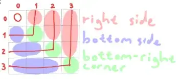

If your corner is grid[0][0], the nth bottom-right outline consists of squares where one or both coordinates are n.
nth bottom-right outlines up to 3
This generalises to: If your corner is at grid[x][y], then the bottom-right outline is a union of these sets of squares:
  • grid[x+n][yVariable], where y <= yVariable < y+n (the right side)
  • grid[xVariable][y+n], where x <= xVariable < x+n (the bottom side)
  • and finally grid[x+n][y+n] (the bottom-right corner)
It should be easy to iterate through these. If you have a quad, the top-right and bottom-right corners' coordinates tell you where it is.

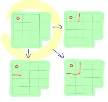

Generalising to rectangles
Those three bullet points above can also be checked for individually:
separate checking of sides
This of course means that from any state of checking, 3 (instead of 1) possible further states may evolve:
the three checking states that follow from a the trivial state
Each of these three states can each be further expanded into up to three states by a similar method.
Your code could save the two other states for later and process the first to exhaustion before continuing with the next. At the end, the quad with the largest area would be the output. (This is, in computer science terms, a depth-first traversal of a trinary tree.)
