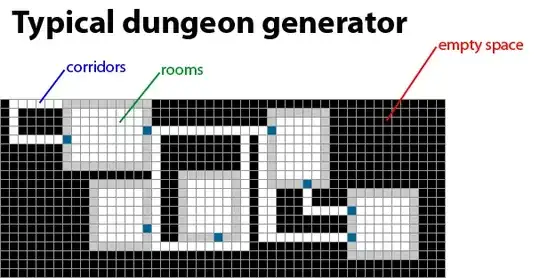

Here are some images to make this a little more clear:
Typical dungeon generator Dungeon with no corridors House generator result
As you can see, in the house, the "empty space" is still walkable and it gets you from one room to another.

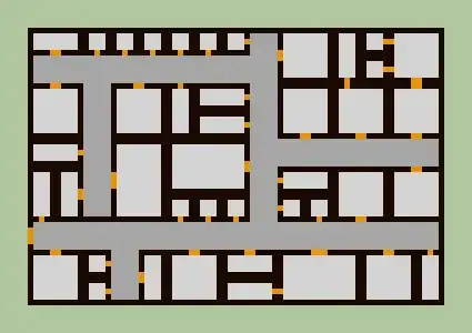

So, here is how I solved this problem. But first, I'd like to thank both @Shadows In Rain and @egarcia for their answers. They gave me a good direction which helped me get some results.
I used Shadows In Rain's space partitioning to generate a basic house and then followed egarcia's advice to fill in the area with rooms.
The space partitioning was pretty straightforward since 90% of the code was done by Shadows. The "fill in the rooms" part was a little more challenging. I decided to use a pseudo AI Planning system that uses A* to position the rooms appropriately. The good thing about using planning instead of just A* is that the preconditions help cut down the search space significantly.
Here are some screenshots with the results:
Floor plan generation phase Floor plan generation phase
Room placement phase Room placement phase
Now with connecting doors!
