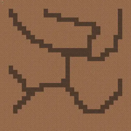

This using a few functions from a program called Realm Factory, which is a tile editor. The numbers "20, 20" are just a sample of the level I made below:
