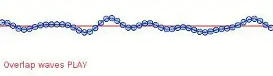

Background waves (stacked sines)
Natural background waves look to me like a bunch of sine waves (with different amplitudes, phases and wavelengths) all summed together. Here's what that looked like when I wrote it:
background waves produced by sine interference
The interference patterns look pretty plausible.

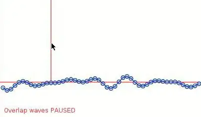

All together now
So then it's a pretty simple matter to sum together the splash waves and the background waves:
background waves, with splashes
When splashes happen, you can see small grey circles showing where the original background wave would be.
It looks a lot like that video you linked, so I'd consider this a successful experiment.
