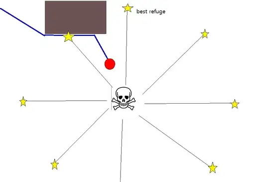

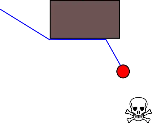

How about focusing on predators? Let's just raycast 360 degrees on Predator's position, with appropriate density. And we can have refuge samples. And choose best refuge.
case 1
case 2
