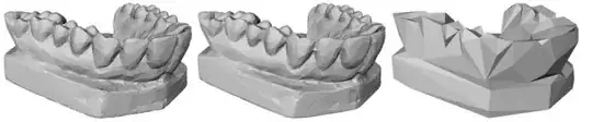

The best results I've seen for this when a mesh is decimated. Decimating the mesh attempts to reduce the polygon count with minimal shape changes. The decimated meshes retain their shapes fairly well and this would be ideal for non-organic structures like buildings. Though it even works on organic structures as you can see here:
There are a few different techniques at work here. Such as estimating an average plane, performing "half-edge collapses" and more. There are numerous publications available that discuss implementing a decimation process. For further reading:
